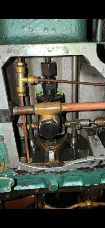

Pedro
  • Posts: 3
Re: LPW 4 Engine oil change with in very cramped conditions
« Reply #4 on: December 28, 2024, 06:09:10 PM »
Thanks.
There is such a pump. I uploaded a photo of it just in case someone has a similar question in the future.
https://flic.kr/p/2qCk9af
Diesel Engineering
  • Jr. Member
  • Posts: 71
« Reply #5 on: December 29, 2024, 01:15:16 AM »
That does appear to be a sump pump in your photo. There may or may not be a valve on the bottom which needs opening. Also run the engine up to temperature first, it will make pumping a lot easier
