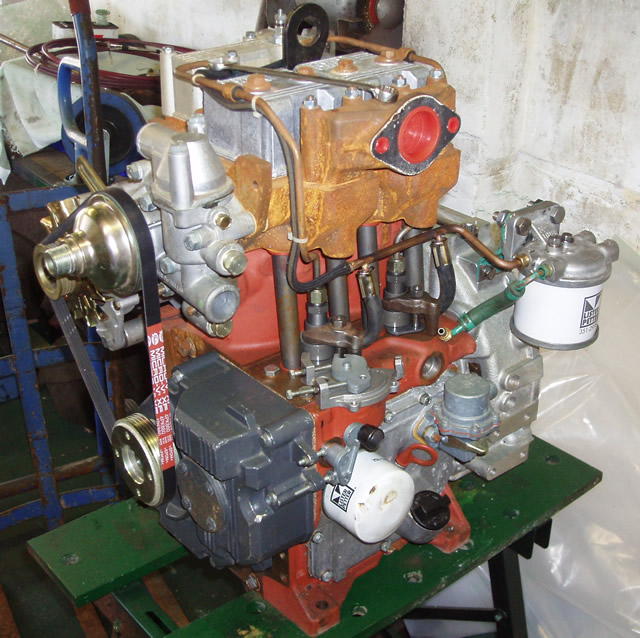

One thing to check for that no one has stated yet is are you sure the voltage is correct for the motor, Some motors I have seen fitted to the JP range of engine are 24V rather then 12V since these are big engines the 24v motor requires less amps than a 12v motor and hence means the wire used can be of a smaller gauge then if it were 12v, there should be some numbers stamped on the motor casing, as well as a rotation arrow to denote the rotation that the motor is turning, If you can find them and post them here or even a photo of these numbers and a general photo of the motor I am sure we can tell you what motor you have currently fitted to your JP2.
