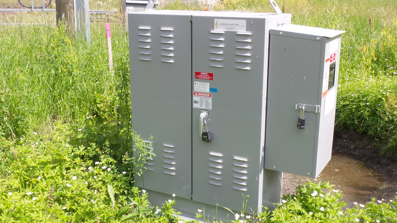

Located 1.5 miles from my home, 300 solar panel array. Set up as three phase.

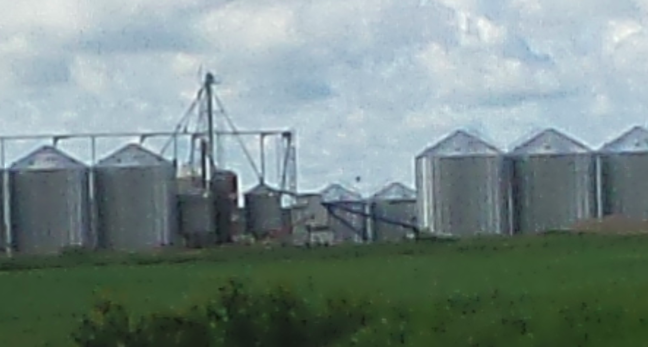

Our ISP has a repeater mounted on the high point and the inverter for the array resides inside the white building.
Internet outages coincide with sunset and sunrise, I suspect it has something to do with the private system being switched onto or being disconnected from the grid.

« Reply #7 on: July 12, 2020, 01:27:19 AM »
The solar array uses Switchgear, inside there's a mechanically ( motorized ) operated load break interrupter.
The interrupter is much to slow in terms of the electronic needs for the radio repeater, any loss in power the system has to reboot.
The reboot at the bin farm lasts about 20 minutes, once service is restore to the repeater radio and the signal once again beamed into our village the routers supplied by the service provider take another 20 minutes to establish an IP address.

Got it figured, but having trouble convincing the IT people who maintain our internet service.
The ISP installed electronic gear inside the electrical utility building that services the bin yard when switchgear for the solar changeovers take place it creates a ripple which in turn creates an electrical magnetic storm inside the building.
