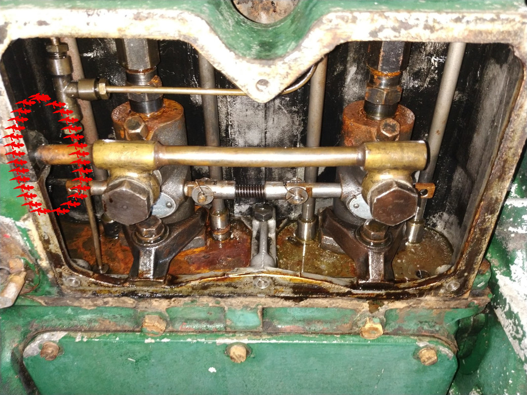

« Reply #13 on: May 28, 2020, 09:22:56 PM »
Remove the cotter pins from each clevis, then move each rack, if one or both fuel pumps are seized it will show up immediately. It's my guess the problem is circled in red.
Remove cotter and clevis nearest the red circle, I think the rack is going to move once disconnected.

« Reply #14 on: May 28, 2020, 09:51:46 PM »
Hi, and thanks in advance.
Just to clear things up in my mind.
The yellow arrow points to the start run stop button, of which I could only get it to the start and run position, not the stop.
I could get fuel to flow freely out of the bleed (?) Bolt above the fuel rail (green arrow).
I could not get the rack to move left or right (blue arrow).
So would that be seized in the fuel pumps or further to the left, and should I be able to get the run switch to all 3 positions?
