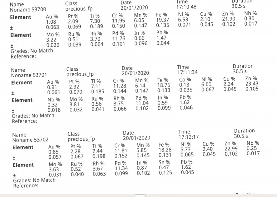

Here's an assay from a sample I sent in. If I did the math right 3.70% rhodium 2000 pounds would be 2003.7 grams, 31 grams troy ounce we have 64.63 tr oz. At today's market value
there's $6527.63 USD of rhodium.
Without an assay the yards are clueless.
The assay below was done with XRF, three shots were taken of the sample being assayed. The duration of x-rays beamed on the sample was 30 seconds
