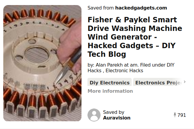

  • Posts: 205
Re: Car engine ignition conversion
« Reply #29 on: March 08, 2020, 05:27:23 AM »
Glort,
If you can find a wrecked older honda civic hybrid or insight hybrid they have a permanent magnet generator (IMA) packed just behind the flywheel. I believed they output 120v'ish 3 phase AC.  but the coils could be rewired in parallel to lower the voltage or just rewound for a 12v or maybe 24v output
That would make a nice stationary motor conversion for topping off the solar batteries.
That was in the early 2000's when they where using the 120v Nimh battery packs.
Fisher & Paykel Smart Drive Washing Machine
