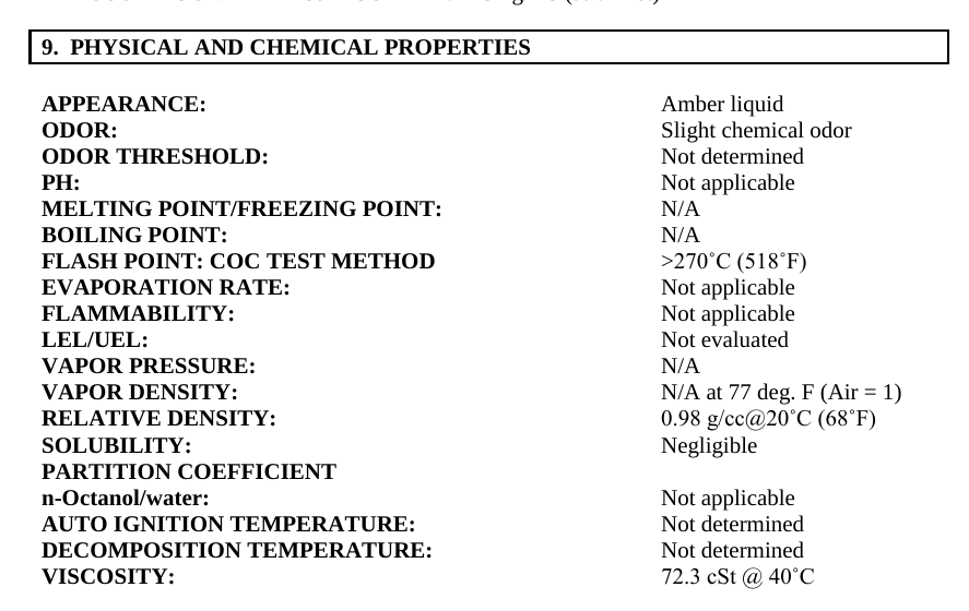

I just finished reading the MSDS for synthetic refrigeration oil, I suggest that you do the same, as there are health implications noted.

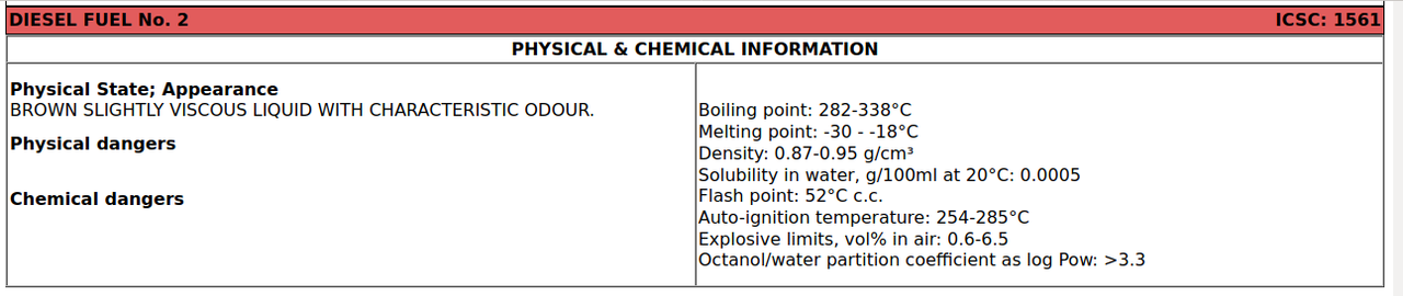

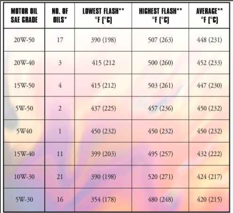

Flash points
« Last Edit: December 16, 2019, 09:41:19 AM by snowman18 »
