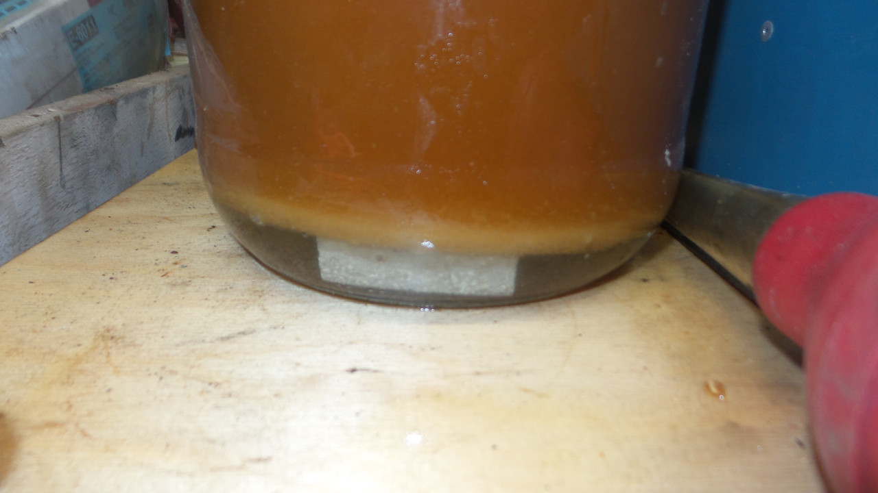

Observation, the oil used for this experiment contained enough moisture to form gas bubbles when a DC current was passed through the oil.
After about an hour it was observed that the infusion of gas bubbles had caused the oil to become cloudy. The bubbles had dispersed overnight and the oil was once again amber in color.
The hot pan test showed the test oil to be free of moisture.
Oil from the 16 liter jug is the first to be deposited into the hot pan which shows it to be free of moisture the second drop is from the test oil.
Electrolysis showed evidence of moisture as the infusion of minute gas bubbles had turned the oil cloudy. The standing overnight the gas had a chance to rise once the gas had dispersed from the oil  the cloudiness disappeared.
The experiment was based on the electrolysis of water to make hydrogen gas as a fuel, the Ph of the oil told me that it would conduct a DC current and it was my theory the DC current would break the moisture bonds into their respective gas's.
I encourage others to duplicate this experiment then report your observations.

+1 but no cigar, water moisture in waste cooking oil donates the H atom to give a notable ph, depending on which foods were cooked in the oil will determine of the Ph is alkali or acidic
Fortunately both will conduct an electrical current, I do not have ph strips so the test oil was from the fryer so to speak to the test jar.
You did mention earlier that vegetable oil was hydroscopic and I have since read material that supports your claim.
So it would be safe to assume freshly processed cooking oil could pick up traces of moisture from humidity in the air.
From the oil used for this experiment neither the oil from the 16 liter jug or the test batch showed evidence of moisture on the hot pan test.
As I mentioned earlier the test batch turned cloudy, for what its worth I'm going to run this experiment again.
Only this time I'm going to add 1/4 cup of water then thoroughly mix it onto the oil then at the end of the test do the hot pan test.
Personally I think I've stumbled onto an economic method of drying waste vegetable oil

I've added 400 ml of water, 10:00 pm Sunday evening.

I never expected that the whole 400 ml of water would stay with the oil, after an hour and a half there is now a layer of separation.
I've upgraded the DC power supply to 12 Volts DC at 30 amps, I will make a daily report on this experiment for one week.
My shop at the moment is not heated and it's freezing outside. Warming the oil wouldn't hurt but going do do this with out.
With the oil being cold and thick I'll give it a stir once a day to help disperse the bubbles, if any appear.

To cold in the shop, I've terminated the experiment.

You were pumping 30A @ 12V into that 4? litre jar.
That is  30x 12=  360W. I would have thought that would be plenty to heat the solution to a workable room temperature.
Of course extrapolating that electrical input, we have 360W x 24 Hrs = 8.64Kwh a day, x7 = 60.48 Kwh week.
That's a shit load of power to dry a few litres of oil!
Even if it only takes half the time to dry it, still an over the top amount of power to dry even 100X that amount of oil.
Water pump I used on my dryer was 400W and even in cold humid conditions I could dry 200L of oil in 3 hours and that was worst case scenario. Average was more like one hour.
Perhaps this setup will not be the breakthrough I hoped for.

In part because of the cold, and the water no longer had the propertys required to carry a current, could have added a small amount of table salt to encourage the flow of current.
I made the mistake of using the same oil for the second experiment, I figure the salts and nitrates from the foods cooked in the was electrically changed. If I had PH test strips on hand I could verify if any changes that may have taken place.
Electrolysis of salt water produces chlorine gas and hydrogen along with caustic soda all of which would have damaged my titanium electrodes.
In the near future I plan to plantinise the surfaces of these titanium electrodes to use in other electro chemistry projects.
In this tube video he as added baking soda to make the water conductive, which in my opinion would not adulterate the oil for our use.
