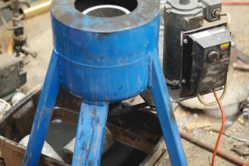

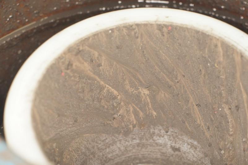

glort high speed centrifuges are capable of separating isotopes from gaseous mixtures, this is how they enrich uranium.
https://en.wikipedia.org/wiki/Gas_centrifugeHow many G forces was your centrifuge producing, where you running cold oil or did you first heat the oil to improve its viscosity, which would encourage the water to drop out.

Oil is lighter than water, increase the speed of your centrifuge and warm the oil before feeding it into the centrifuge the water has no choice other than to be liberated.

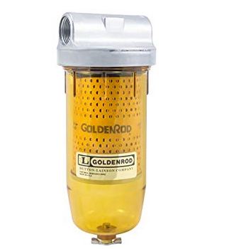

Also have you installed a water separator into your engine fuel system.

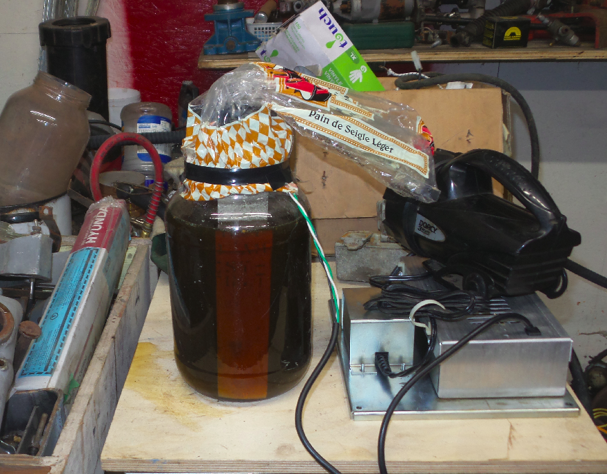

Bubbling air through your oil is no guarantee your going to end up drying the oil, air itself has a lot of moisture content.
