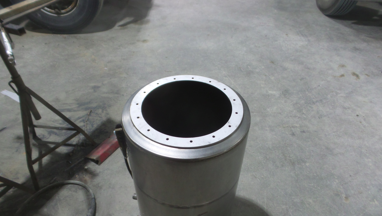

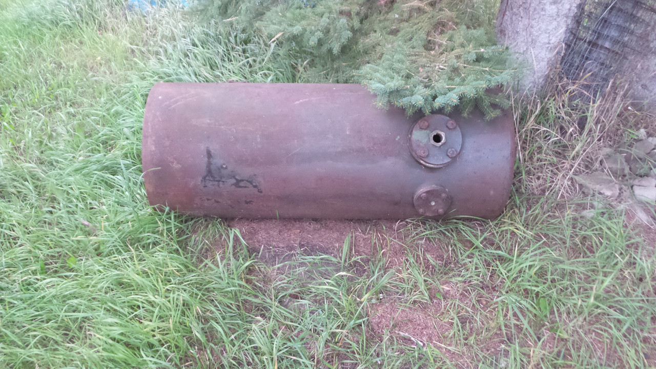

I'm starting off with a 30 gallon still, the top has been opened up by removing the top a stainless steel ring will be welded to the tank.

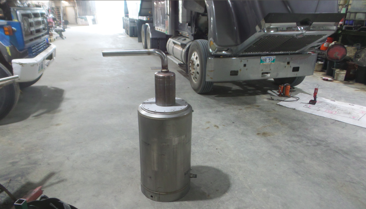

The wide mouth will make emptying the tank and reloading a simple operation, I have cut two identical plates that will bolt onto the top of the tank, One plate is fitted with a simple outlet for the steam leading to a condenser.
The other plate has a taller stainless tank affixed to it which will be used as a re-flux column for processing spirits.
The tank has a threaded inlet near the bottom, when its being used to distill essential oils steam will be injected on this port. For spirits a threaded electrical heater element will be in inserted into the port.

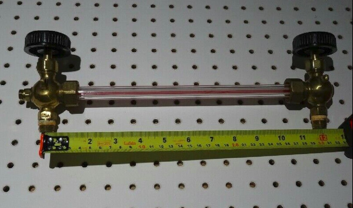

Bits and pieces.
Sight glass for the steam generator next are the stainless steel tank the larger one will be used for the reflux.
Holes have been drilled into the bottom to allow spirits free passage.
Steam generator shell, this will be cut to length then have the boiler tubes installed before its placed onto the wood heater.

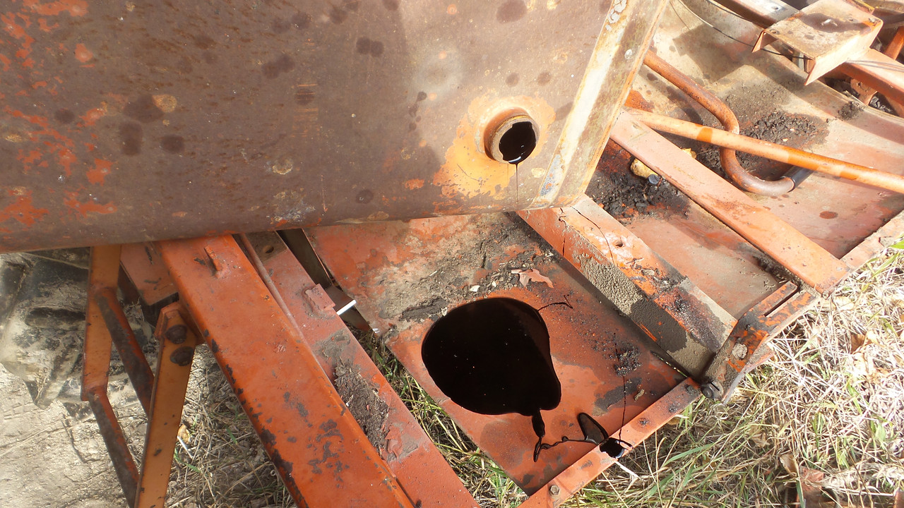

The silage chopper as found, $75.00 later I own it.

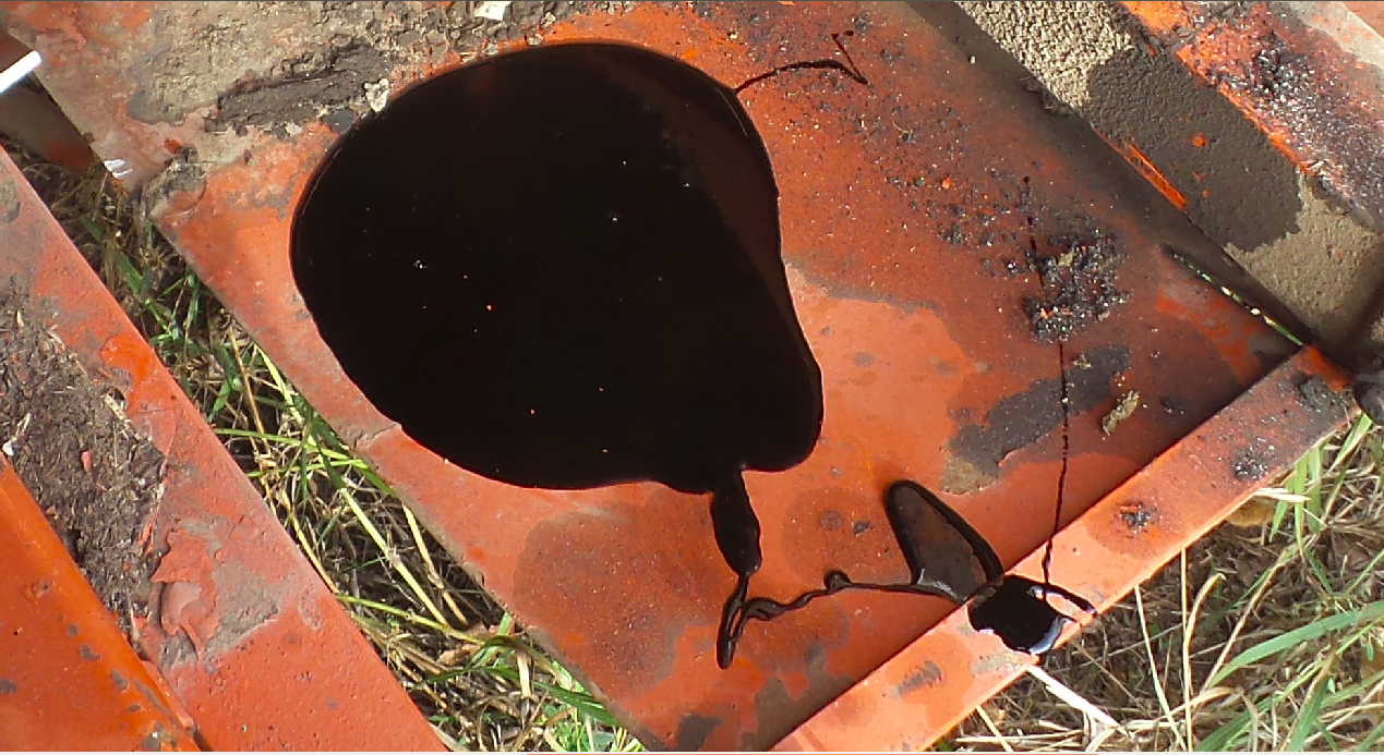

Pictures below the Wisconsin showing how the old gasoline had turned to bitumen.

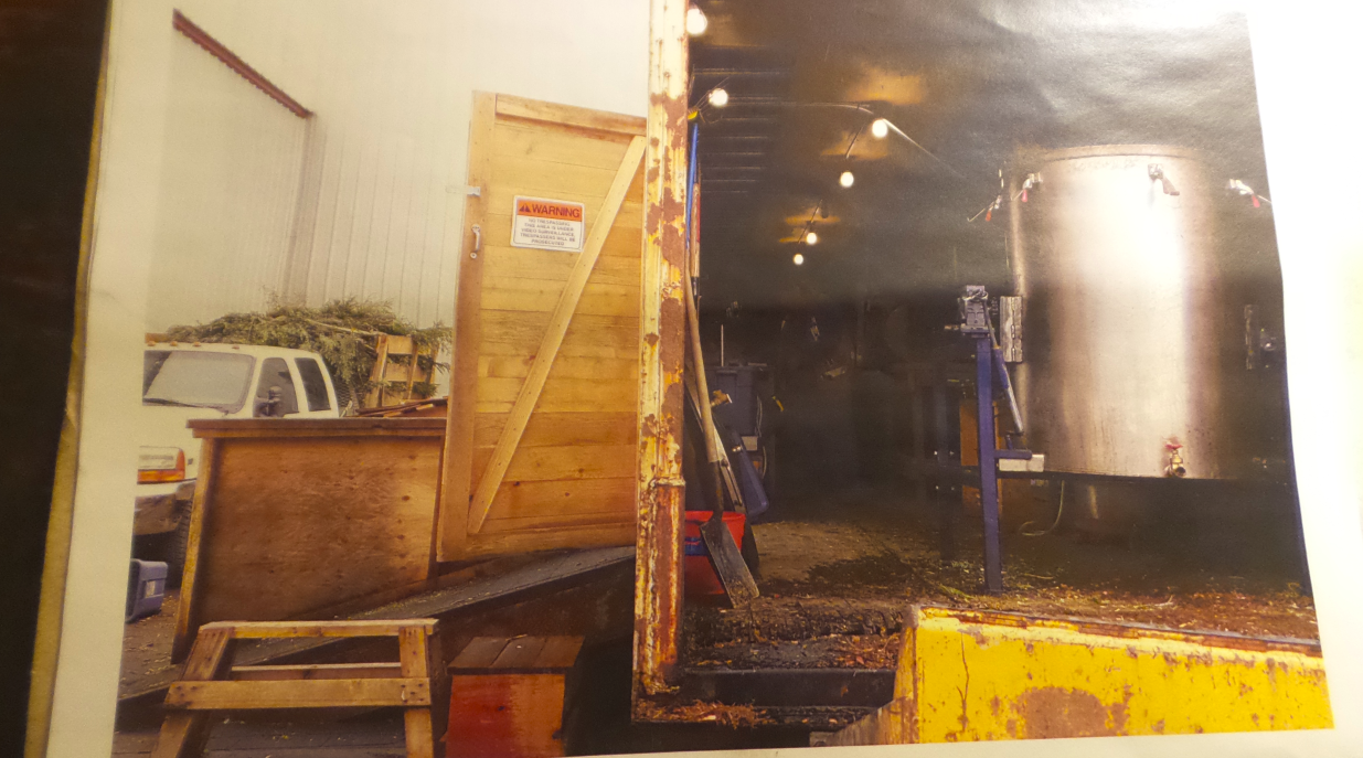

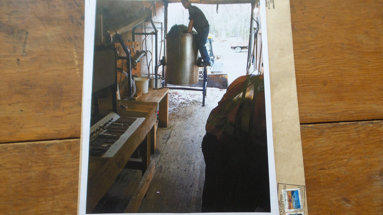

The Natives at Bella Coola BC operate a small essential oil still, they were kind enough the send me some literature along with a few pictures.
The distillation is done with steam and the large vessel is emptied via a hand cranked gear reducer to tip the contents out.
In these pictures they're distilling cedar oil.

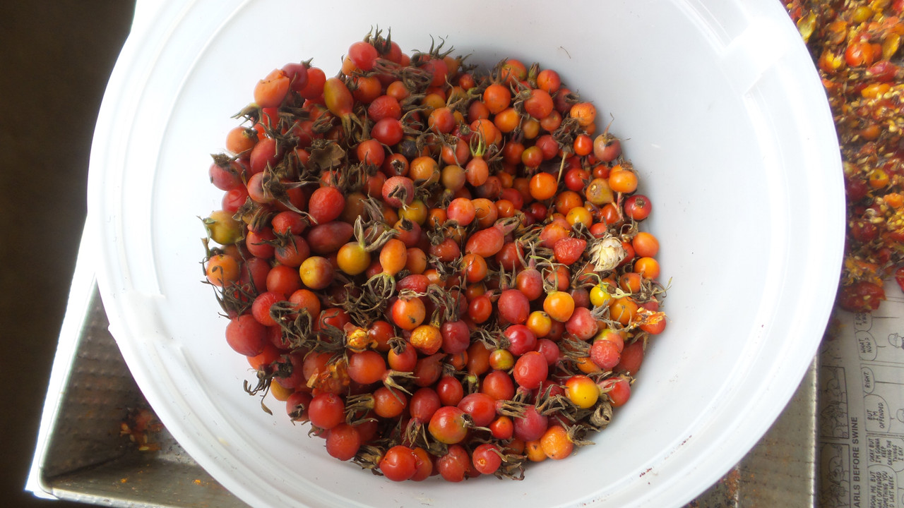

Aromatherapy using essential oils is becoming very popular, I'm not a practitioner but working with rose hips rubbing the pulp between the palms of my hands did relieve arthritis from my thumb on my left hand.
The outer shell of the rose hip is used to make tea while the seeds are pressed for their oil.

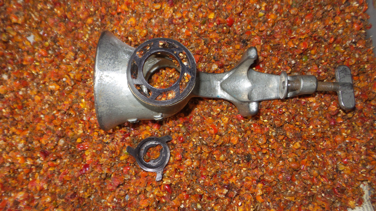

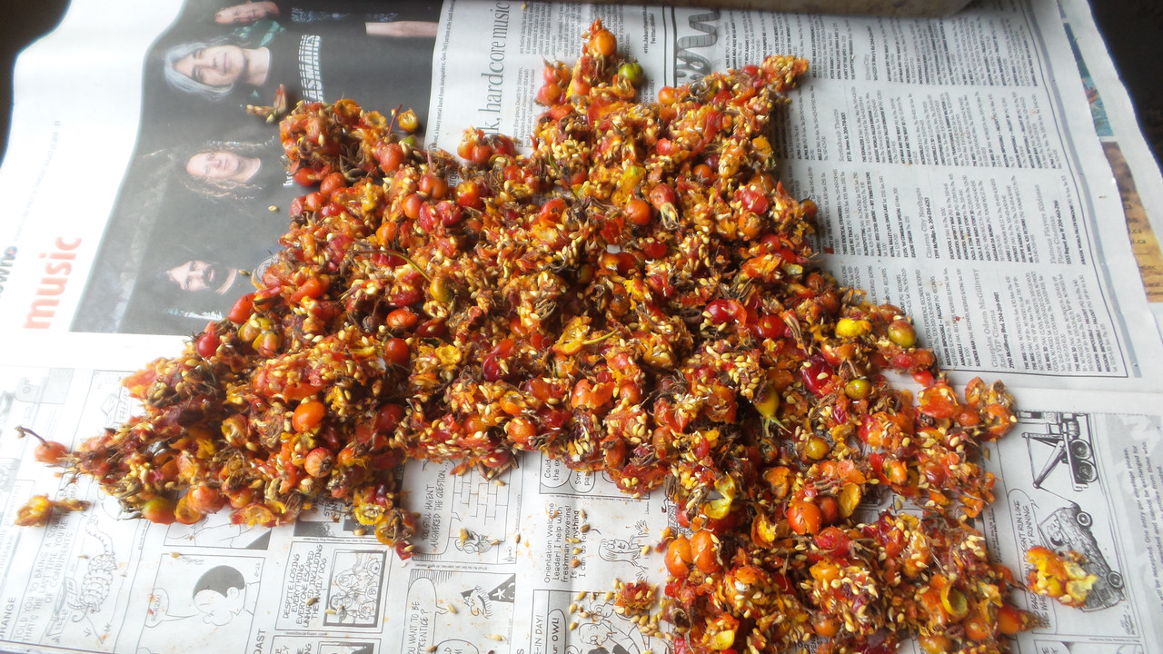

I put the hips through this old meat grinder, then air dried to pulp for a couple of days, after drying the seeds were easily liberated by rubbing the pulp between the palms.
I've given the pulp away to those nearby who wish to make tea from it, the seeds are waiting to be pressed for their oil.
I did purchase a hand cranked oil seed press that I'm going to modify by adding a gear reduction drive to.
