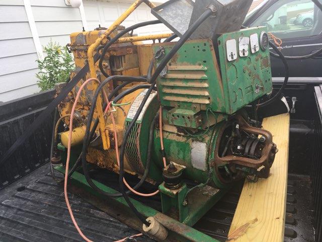

The guy called me today about the engine. I spent the last 5 hours on the road in pouring rain, but I got it home. The data plate does indeed say its an ST2. It has 1262 hours on it (or at least on the timer on the gen head). The owner started it up for me and it seems to run fine. He said he tried to run WMO in it, but it ran hot so he never tried again. Thats the main thing I'm worried about. What would make it run hot, and what do I need to check because of this?
The Kohler generator head produces power, (we tested it with an angle grinder). Now to get it off the truck and tear into it to learn how it works and clean it up. I want to restore it to like new condition, so if anyone know if it was the yellow color, or green, let me know. Also, and knowledge about the gen head would be extremely helpful!
Any information you can provide me about the engine will be greatly appreciated.

And here is the gen head:

Congrats! Nice looking project there. The gold on the generator head is an original Kohler color. I think yellow is a pretty common Lister color as well. May have been two tone originally. I would probably paint it all Lister(mid-brunswick) green or all Kohler gold. How did the Tacoma do on the road trip?

Congratulations Lastlaugh, Should be a great project and give you enormous pleasure and hours of frustration. Looks like that Kohler head has three slip rings so it`s probably three phase.
If the engine was overheating it is much more likely that the cooling vanes on the cylinders are full of sh1t. Mine was completely covered in a mixture of dust, oil, chicken feathers and mouse droppings.

You are correct on the cooling vanes. I looked inside the cage and it looks like there is all kinds of trash up in there. I'll be taking it apart to clean it as soon as I figure out how.
As far as the gen head goes, I'm still learning! have a good basic knowledge of electronic principles but its been a long time. (I wasnt aware they were called slip rings, but I understand the concept now. (each ring is capacitated 120 degrees off phase). I've never worked with 3 phase power, but now I'm intrigued. Will this work for standard house backup in case of outtage? Do I need to convert it back to single phase or will it just use the first phase for single?
I'm looking for a manual for the kohler, so if anyone has experience with the head or know where i can get one, I will be eternally grateful!

......... I've never worked with 3 phase power, but now I'm intrigued. Will this work for standard house backup in case of outtage? Do I need to convert it back to single phase or will it just use the first phase for single?
With 3 phase, the power is split over 3 sets of windings, so any single winding has 1/3 rd the power, if it's a 9Kw gen head, only 3kw per winding.  otherwise, you need a expensive 3-ph transformer that will convert to 9kw of usable single phase

Thats bad news on the gen head. 8.5kW is enough to power my cabin. One third of that is not! I may have to look up how to wire it to single phase.
Not Necessarily.
Depending on how the generator is wired/ built, it may ( and Usually is with our power system gennys here) to wire the outputs so you can get 3 or single phase out the same head. I don't see why it would be any different with US standard gennys.
Not all of them can do it but if you have a 12 wire output you certainly can.

I'm not sure if its a 12 wire output or not. I'll get better pictures when I get home.
