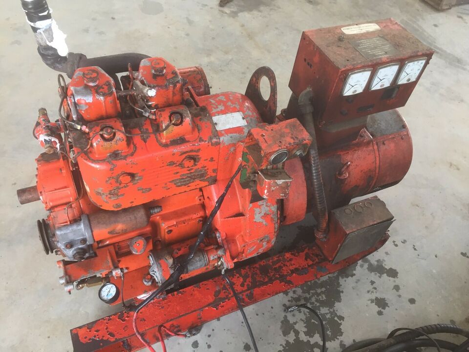

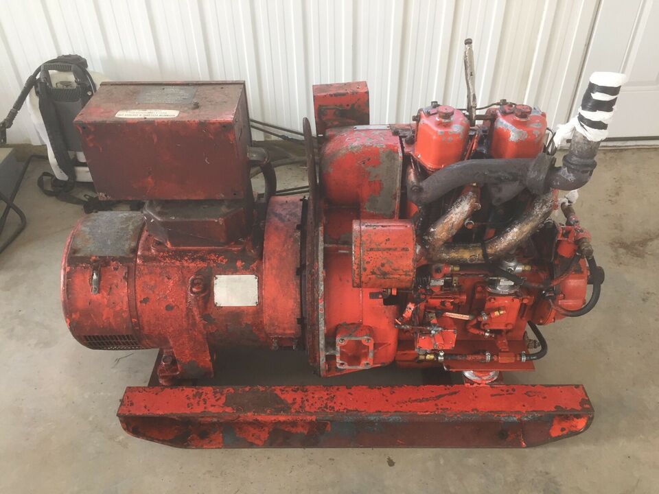

I just purchased this PJ2 the serial number 7399 says it was built in early 1968 its the real deal. The engine is coupled to a 15KW Stamford head.
Paid $1300.00 FOB Ontario the previous owner is shipping it over to Manitoba on a Cattle truck that makes routine trips. Expect delivery sometime on the upcoming week.

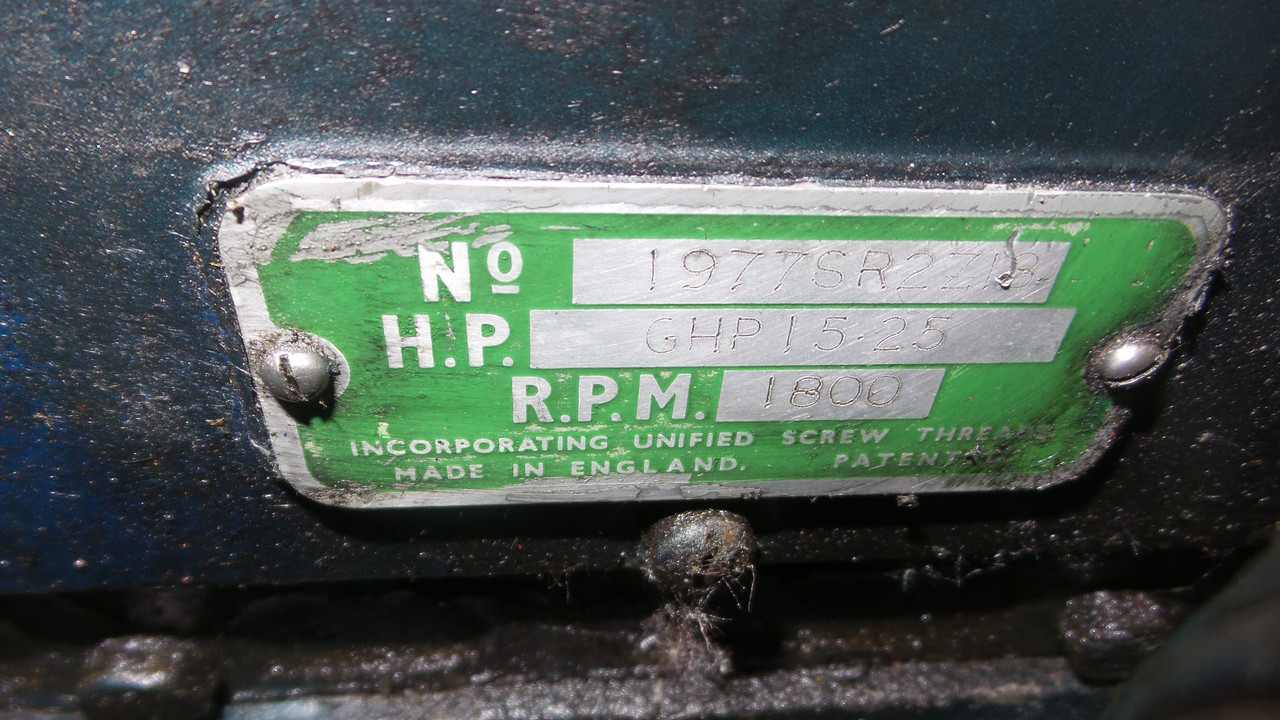

Here's a SR2 that I had purchased a year ago it has a start o matic generator head.
