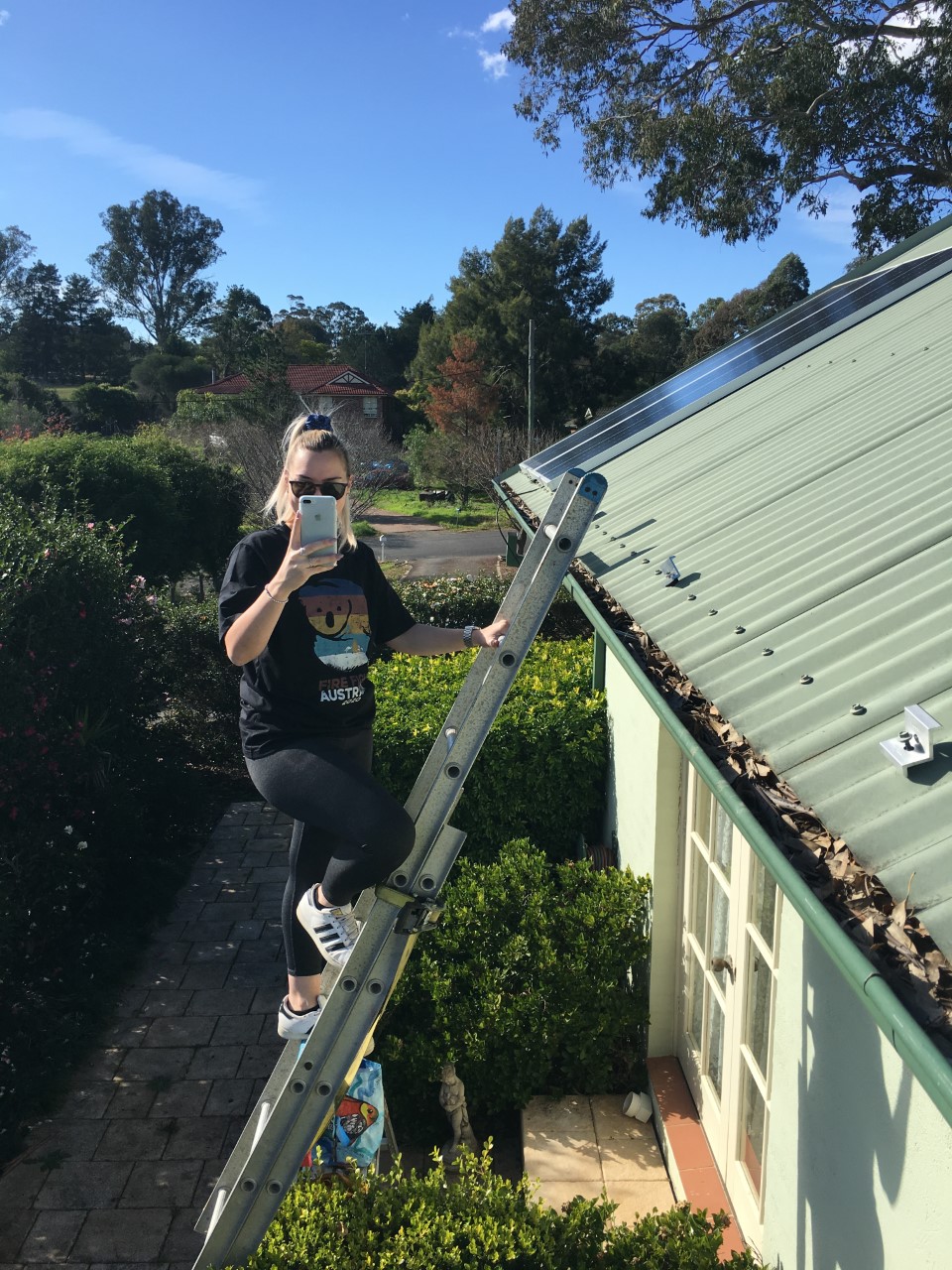

Daughter was home today and I had " reserved" her services on the weekend to help me ( again) put panels up.
I have been doing the mental Arithmetic for 6 Months how to put them on the North house roof which is tin, 34o angle and slippery as .
I have saved this ideal winter roof in the though that maybe one day I'd have to go a legit system but having picked up 6.5 Kw of dumped but brand new panels at Christmas, I thought they would be worth using there.
I have spent hours thinking about how to do them but the ones I did last week went really well so I was confident of these ones. Mostly.
These were 360 and 405W panels and they are OVER ( as I discovered today) 2M long.  Bloody big things to handle especially on a steep tin roof.

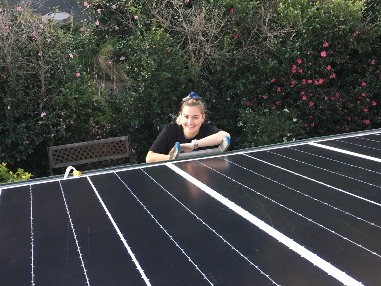

Started much the same way as the others.  Got one up on the roof from a ladder and pushed it across to a clamp bracket I had put in the roof screw hole.  Clamped it sown then got up on the verandah roof and onto the main roof over the top of the ridge.  I used my DIY safety  point I made and removed a few of the topmost roofing screws and put them back through that.  I bought a thick rope the other day and that went round the middle a couple of times and tied it off with some non slip knots.  After the other day I wasn't as much worried about falling as I was thinking of something to hang onto to manoeuvrer around.
I pretty much laid on the roof and used the first panel as a foot hold and there down the tie down strap to my daughter whom moved a panel to the ladder and hooked the panel onto the strap hook.  From there she guided the thing up the ladder as I pulled it up.  We pre set the end clamps so I half pulled the panel over the other one then slid it across to engage the clamp.  Again I put a dollop of roof silicone under the clamp to ensure water proofing.  Daughter came up the ladder, connected the panels together,  made sure the wires  and connectors were under the panels, helped me align them and screwed the clamp down.  She moved the ladder across, loaded the next panel and rinse and repeat.
BLOODY good job for the princess of Princesses. I know bloody well she would have done better than her male Cousins round the corner, they have helped me before and they are far bigger girls than my daughter is.
She did a really good job and I was impressed.  Made my day when she asked me which side did the panel have to go to, the positive or the negative? I have seen / heard " professionals " refer to polarity as plus and Minus and it's a pet hate of mine that shits me to tears. The fact she without coaching said it right made me very proud and happy.  These panels were Different to all the others I have put up. The 405's had a connector at each end. The 360's had them in the middle each side.
I thought the idea would be that you didn't need an end cable to come back to the last panel, you could join the 1st and 3rd and continue that way so you ended up with both poles at the end. Well you could IF they made the *&%!#* leads long enough instead of the 100mm short!  That was another 10M of cable for each string plus 4 More connectors.  Ah well.  ran the cable over the roof and down to the inverter. That will go in the roof once I decide the best way to do that.
Did the first row and then went in for a cuppa and a bite.  Came out and wired the first array up and hooked it to an inverter and started making power. Brought all the next row of 360 Panels down and strategically place them to make it easier for my little girl to put them on the ladder for me to haul up.  The second row went a bit slower than the first as I had to do all the securing and put in a lot of extra screws to clamp the panels down.  I was wary of the top most panels as we get VERY blustery winds here so I wanted to make damn sure they stay put.
I'm satisfied that no panel is going to come off unless it has the roof truss and the roofing Iron still attached.  The end panels I triple clamped with even larger screws as they are the ones that get the most force. Also had to space some of the panels a little uneven to allow for the roof corrugations but that gives more room for expansion and contraction :0)
Time we were done the light was fading but being up there and being able to see all the other arrays gave me a good idea of the shadowing and timing thereof.  These panels are in the perfect winter angle and orientation and being brand new, should produce good power.

The unhired help in it's natural position.  Never a damn Phone out her hand. Used it to play her hardstyle music on her surprisingly powerful ( annoying) bluetooth  speaker the whole time which she turned it down when I got pissed off with the racket by using her watch.
Showing roof with only 2 Panels in place that were installed from the ground to be used as first footholds.  Also note pre installed brackets  along roof edge used to stop panels initially sliding off roof when pulled up.
Crash test Dummy showing how not to slide off a roof by using panels as a foothold.  Safety Zealots please note approved safety harness and full PPE ( May be hard to make out in pic but trust  and spare me, it's there. Really!)  Yellow webbing was used to hook under panels and haul them onto roof.  ( using authorised and approved safety practices at all times.)

Crash test Dummy holding attachment devise and again displaying full PPE  safety gear and adhering to all required regulations and worksafe  OH&S practices. Said Dummy later went along and corrected sloppy wiring left by unhired help whom Claimed you couldn't see it from the ground, what was the problem??
Completed professional installation.  Well not really professional, this worked straight off the bat unlike some installations done for friends by registered and licenced solar businesses..... that yours truly came along and fixed when installers failed 3 times!
Unhired help up on ladder for 20th and last time happy that it's all over.
