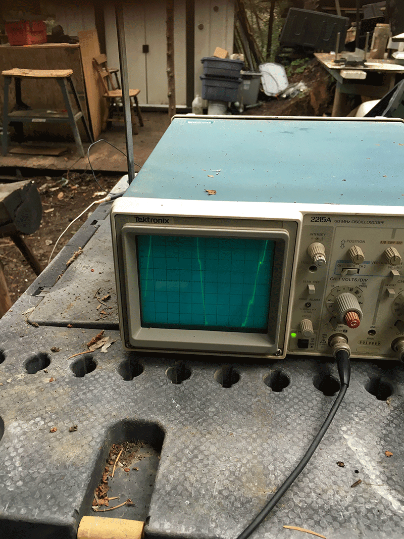

so, got a new ST3Kw (have asked and taken advice in other threads)
hooked an oscilloscope up, still confused of course.
I did calibrate the scope by using my house power and getting the wave all normal and in the screen, centered on the center, etc.
First, check out this short video of the thing running with no load, with a 10mfd capacitor connected:  https://www.youtube.com/watch?v=H466Ff8wG0E
check out the crazy inconsistency.
took the capacitor off and hooked up a space heater.  the wave calmed down, but had a weird jagged bit:
https://1.bp.blogspot.com/-b8xN2BSH9V4/Vt8R2qiW-ZI/AAAAAAAAGvA/7rQFgwlkIHo/s1600/alt-with-heater.png
I'm just trying to get this thing to push power into my outback inverter charger, and the charger won't take it!
6/1 with 2 tank for WVO.  pushing power into off-grid house battery bank, in winter.
You need to change the vertical scale so the entire waveform is visible.  The analog scope can't sync properly as you have it set up.  Your 1st waveform is in fact virtually identical to the second.  I can comment further when you have a full wave visible.

another attempt at showing the wave:
https://youtu.be/OD1t3z0HTBY    no load, no capacitor.
Much better on the oscilloscope this time.
Your ST has pronounced "ratcheting"; some have this more than others.  It should be less pronounced with load.
