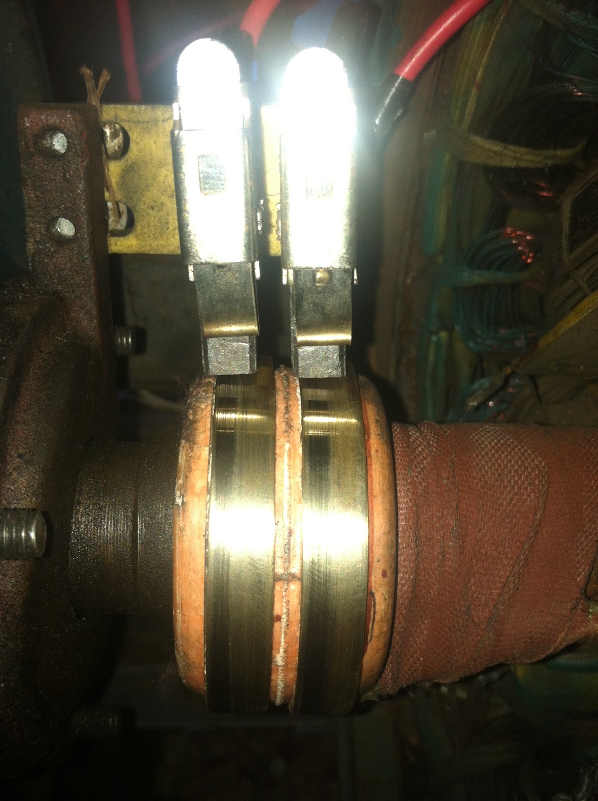

« Reply #15 on: August 08, 2015, 09:13:20 AM »
From your pictures the brush alignment looks off a bit... and one slip ring does not appear very clean. I would clean up those ring surfaces and align the brush holders carefully. You should be able to spin the unit by hand and work it with some crocus cloth or similar fine abrasive... diamond dust (in stick form) used to be the best tool for this purpose, not sure if it is in common use or available today.

« Reply #20 on: October 10, 2015, 03:48:34 AM »
I continue to struggle with this low to no power issue.   I've played around with speed, checked all connections, and I continue to feel it's the brushes, though I can no longer make a change by swapping out different brushes.
running at good speed - 650ish, but I'm not sure - I'm now getting about 50v.  last week, before I started messing with it, I was getting 80something, and hardly any amps.  Sometimes, I could get it up over 100v but cannot any longer.
can someone talk to me about glazing? how do I fix it? could that be it?  here's photos taken today, after much fiddling.  surprising to see how it looks lined up well from one side, and off-kilter from the other.

« Reply #22 on: October 10, 2015, 05:24:08 AM »
Sorry if that was not clear. The diamond dust (in stick form) would be used to re-surface the slip-ring and commutator surfaces while manually spinning the rotor. Resistance checks would be taken from brush lead to any accessible point on the slip ring in question. Replace brushes if in doubt.

« Reply #23 on: October 10, 2015, 10:17:32 AM »
Looking at your pictures it looks as if the brush holder needs adjusting as the brushes are lying at an angle and not square with the rings. The brushes consequently are not making even contact with the rings, as you can see by the shiny contact area on the rings. This may have nothing to do with your voltage problem but it certainly won't help. If, as you say, no further re-alignment is possible I can only assume that someone has fitted the wrong brush holders or something has moved that should not have. I hardly think that any reputable manufacturer would put out a unit in that state.

« Reply #24 on: October 10, 2015, 04:48:06 PM »
merkland
I will continue to try and straighten that up... but I'm sure you know what I mean - there is some adjustment possible built in to the design of the piece that holds the brush holders... but I've maxed it out.  if I tighten down the bolts, it ends up slightly off.
