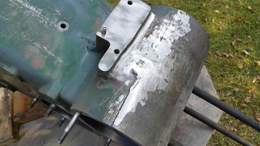

Diesel filter housing has two of cover's corners broken off.
I've done cast-iron welding before on my Fairbanks-Morse to repair all the frost cracks, but I think brazing might be an easier and more appropriate process for this job. Somewhere along the line I ran out of brazing rods, so out came the nickel rods to get the job done.
Pre-heat - weld - peen - keep warm - weld - peen - keep warm - repeat. After welding cool down slooowly - I usually put the parts inside a fibreglass blanket to slow down the cooling process as much as possible.
As with the rest of the engine, this was also filled with water for a loong time. Everything is brittle. I saw elsewhere on the forum that very nice paper element retrofits can be done on these. I'll shelve this for now.

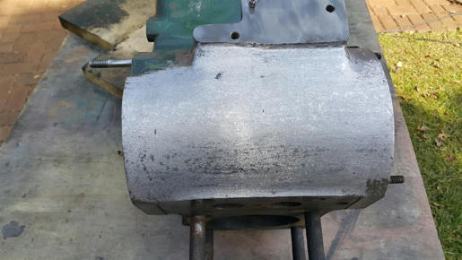

After a couple of hours worth of grinding and sanding I ended up with these parts prepped for painting. (and I was very black). I'm "blueprinting" the casting finishes. All the ugly fettling and casting imperfections are meticulously ground away.

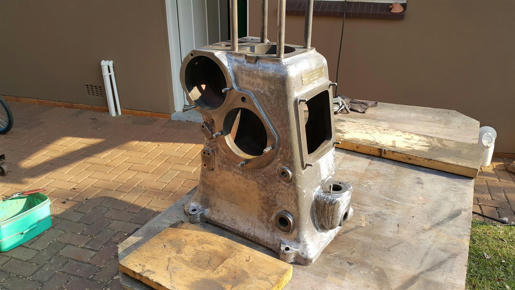

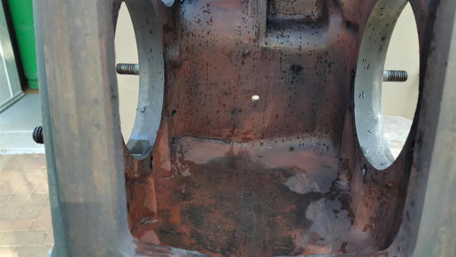

Today's mission was to clean up the crankcase:
After plenty of brushing and blasting the inside with the high pressure sprayer the black stuff is gone...
Mass production fettling done for function, not looks:

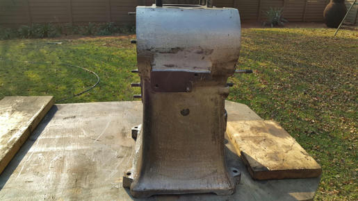

I'm sure if Mr. R.A. Lister had his way the finish would have resembled something like this instead:
Result after grinding away for most part of the day:

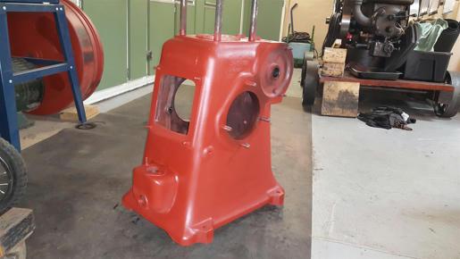

Primer coat on:

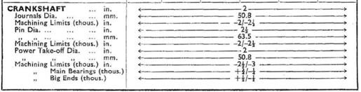

I'm trying to make sense of the tolerance table.
Crankshaft is 2 Inch Diameter.
Machining Limits (thous) -2 / -2   (-0.002" / -0.0025")
SO does this mean the crank diameter can be between 2.000" and 1.998"? Why the 1.9975" size? Am I reading this wrong?
Next problem - The main bearing size:
No idea what to do with that.. +three quarter thou? can't be..
What I need now is to figure out what the main bearing bush inside diameter is, and also what the upper and lower limits are.

I know... a lot of assumptions about the data provided for trained machinists.
crank main journal 1.998/1.9975  this is the acceptable freshly machined range. Maximum wear to 1.990".
crank pin journal 2.498/2.4975 maximum wear to 2.491".
dieselgman
« Last Edit: May 30, 2015, 12:30:50 AM by dieselgman »

« Reply #43 on: May 29, 2015, 08:45:45 PM »
I will have to do some further research but I see a wrist-pin specification for the smaller bore Listers at 0.0017" initial clearance, and 0.0033" maximum allowable clearance in a worn engine.

« Reply #44 on: May 29, 2015, 09:28:14 PM »
dieselgman
Hi dgm. I agree with that.
My plan is to try my hand at babbit casting, so I would really like to figure out what that mains bore should be. I took the other bearing out and funny enough, it looks fine - there is of course some wear in the bearing, but I'm not sure if I it's still within limits.
