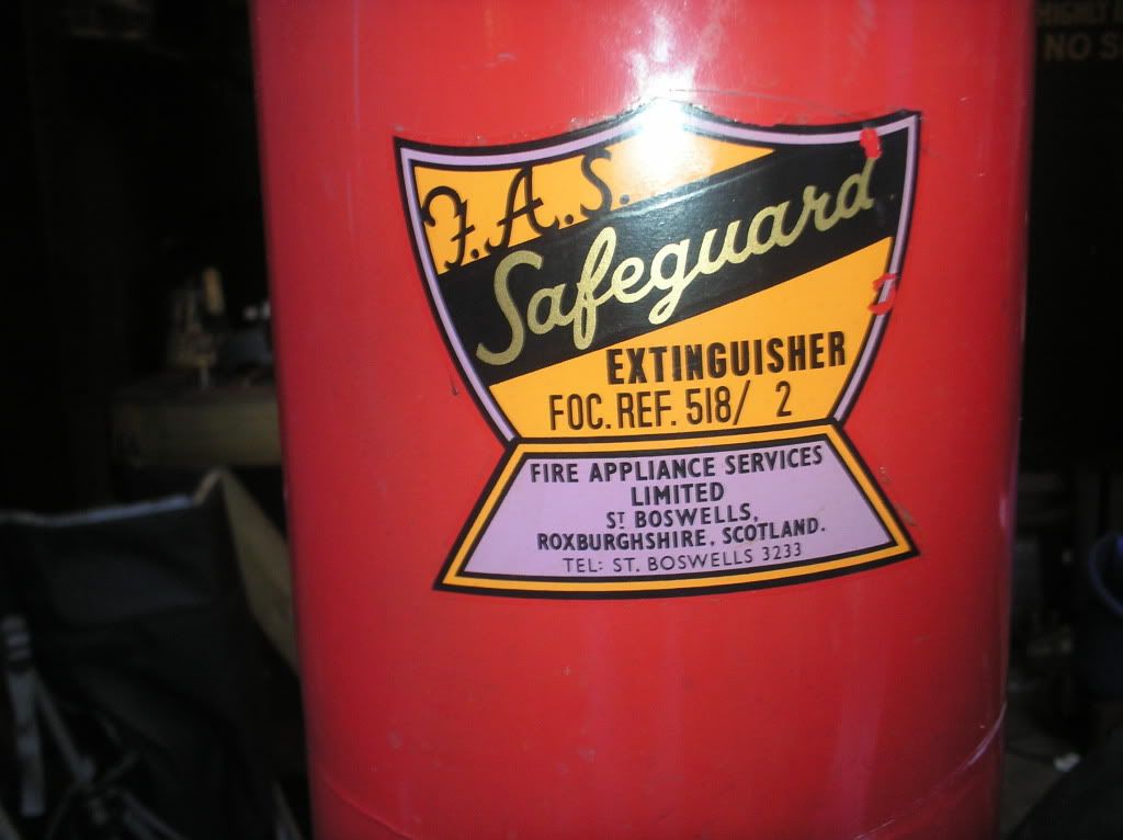

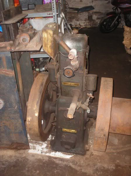

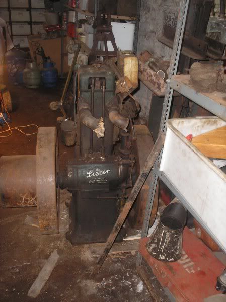

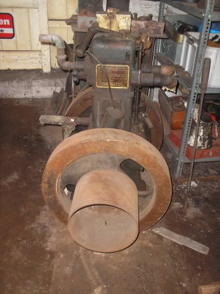

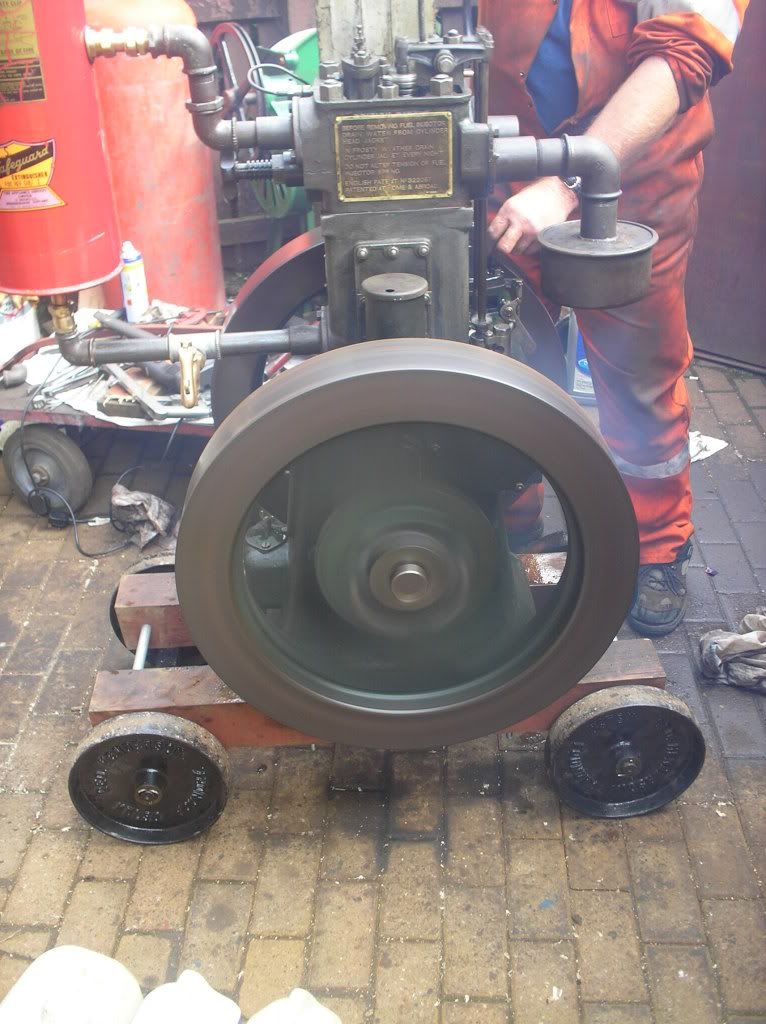

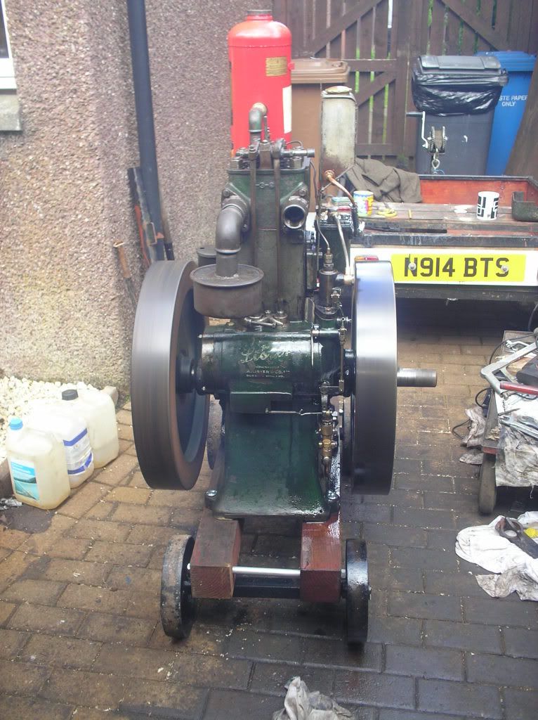

This is my pictures of my pride and joy in the UK. I hope I don't suffer to much before it is finally home in the US. DD

This cooling arrangement may be OK for no load, display running, but I still have concerns.  1.  System volume is too small,  2.  Not enough area to transfer heat,  3.  The weight of the reservoir and the water being carried solely by the pipe fittings.

Bob I know the cooling tank will only work for idle speed. I just think having a fire extinguisher from Scotland is one of a kind. If it looks like it will get to hot I will have to include something else. I am not sure if I want to subject this engine to work. I will run the engine part of the time under a load just to keep it clean and then I will have a better cooling system just to prevent it from over heating. Bill ran this engine @ about 350 RPM for 8 hours and it never got above 100*.

OK.  It might be worth considering putting in a thermostat to get the temp up.  That would reduce slobbering and possibly deposits in the combustion chamber.  The tank does look nice.
Regarding cooling, my Amish friend told me "one 55 gallon barrel for a single, Two for a twin".  These rules applied to working engines.  Most of the installations that I have seen have radiators instead of barrels though.
