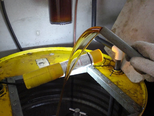

« Reply #13 on: August 01, 2008, 03:36:10 AM »
Here's some of my latest run of wvo, poured thru 600/400/200/100 micron strainers - 1 month in the stand barrel then thru a 10 micron filter and 6 heated passes thru the centrifuge. Crackle test's awesome.
Fred
