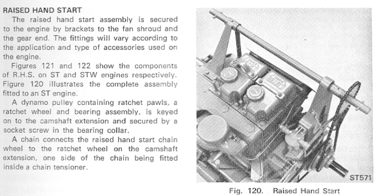

Google  " Raised hand starting on marine engines" there are pictures of all the arrangements
lastlaugh
  • Posts: 38
Re: I GOT IT!!!
« Reply #31 on: August 18, 2018, 02:50:20 PM »
Thanks again for all the replies fellas!
I think I found what "Raised hand start" means:
Which would be really neat if I had all the parts!
I still haven't been able to start the engine since I have had it here at home. I hope to get a battery and fashion a fuel tank to get it started today. I'd really like to fine some sort of air filter to cover the intake first tho.
