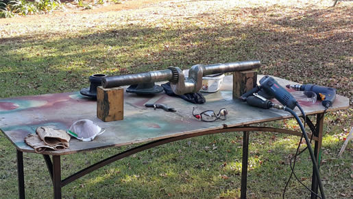

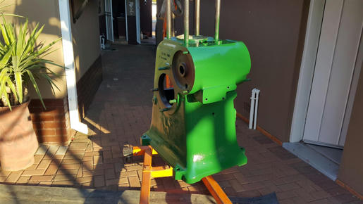

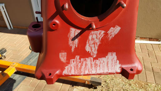

Time to catch up on my latest progress.
The project has now finally reached a turning point. All the heavy dirt is gone, and almost everything is cleaned up. NOW the fun starts!!!
There is still a mountain of work ahead of me, but to finish off, assemble and see all the bits coming together is very satisfying.
Cleaning up the crankshaft.

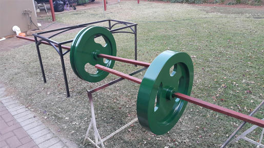

Primer coated and casting pin holes filled.
Time to go green.
I put an unthinkable amount of work into the flywheels. I'm very satisfied with the way they turned out. This is after all the part that spectators stare the most at  ;)

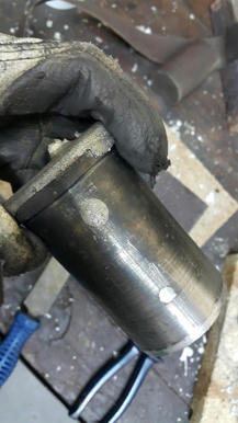

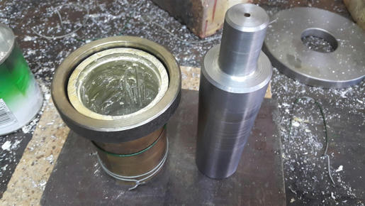

My next venture is to fix the main bearing.

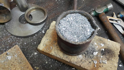

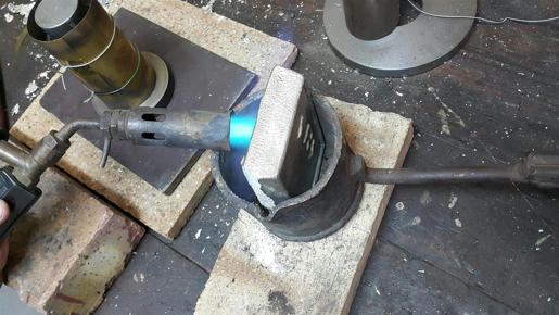

After inquiring about the types and availability of babbit, I was given a 2kg chunk of W.M.40 babbit to play with.
Nothing to loose, so lets see how it turns out:

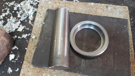

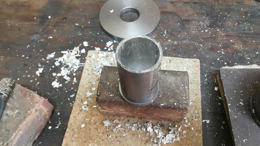

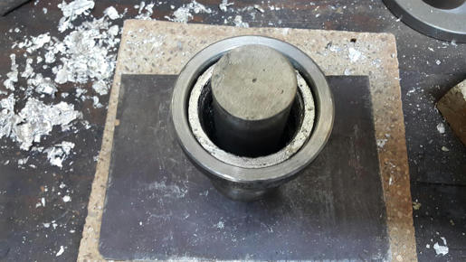

I made a core with a 1 degree draw. Plenty undersize to make the pour easier. The collar is to pour the trust face. (Also with a draw)

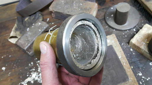

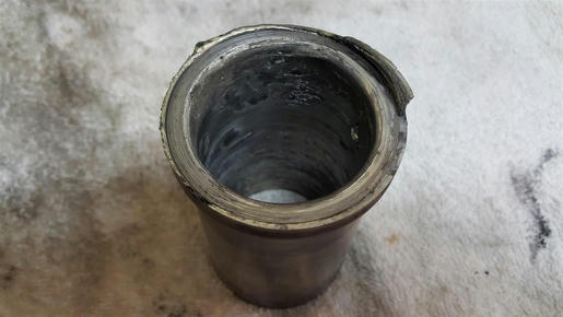

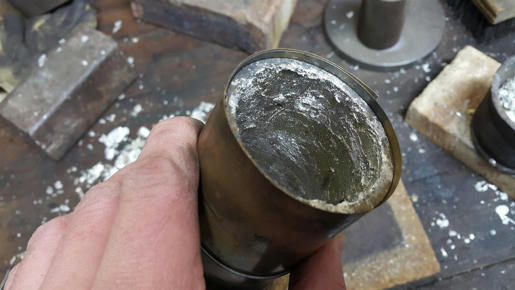

Old babbit melted out:
The bore and thrust face retained their tinning nicely.

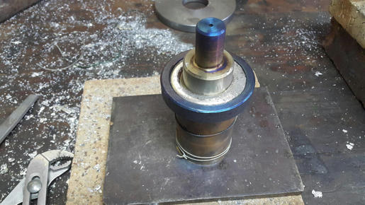

Collar in place:

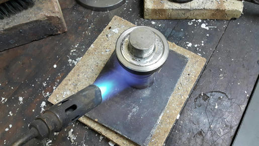

A piece of shimstock wrapped around the bush has 3 purposes:
1 - Hold the collar in position.
2 - Close off the oil holes.
3 - Extend the OD of the bush so the babbit will be longer to allow for machining.

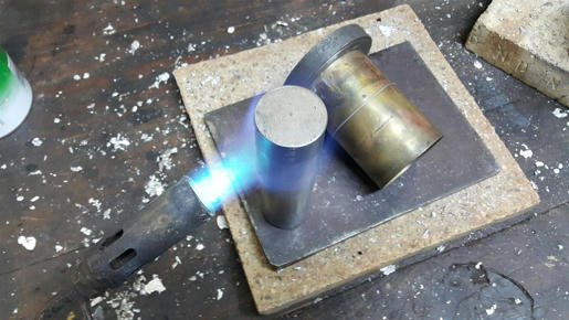

Heating up everything before doing the pour
Pour done:
Core and collar removed. One can see how the length and thrust face was cast oversize to allow for machining.
I'll see if I can get the bush in the lathe tomorrow. The proof to see how successful the pour really turned out will be when I machine it...

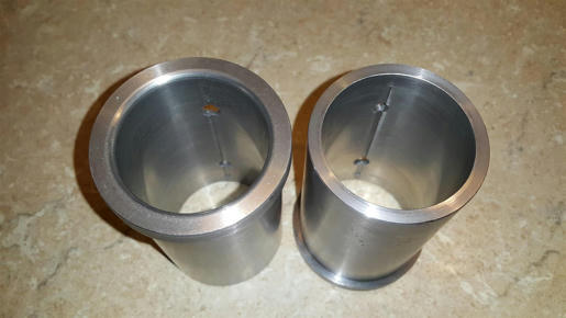

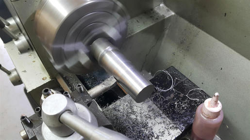

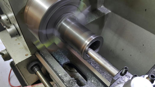

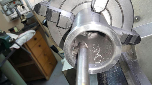

The second casting also came out nice. Before casting this one I had to catch the first one's shavings and make a thicker core. The first one was very thirsty for molten babbit.
While machining I caught the shavings in a cloth - it's very easy to get the shaving contaminated so I won't recommend doing this.
It took a very long time to get the taper and diameter right - but I got it perfect.
TIP: Don't ever hone or sand babbit. Because the babbit is so soft, very fine abrasive particles can become embedded in the babbit surface.
Cutting oil groove:
ALL DONE!!
The bores are crank dia +0.04mm = 50.77mm
Flanges are 9mm. My worn bush measured thicker than a new one, so I erred on the safe side and made it 0.8mm thicker than what it was. I can always shim the housings or machine the faces again after measuring the crank end-float.
