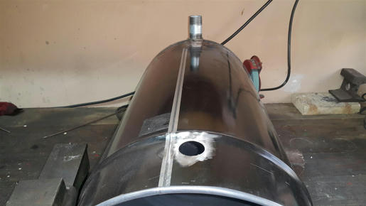

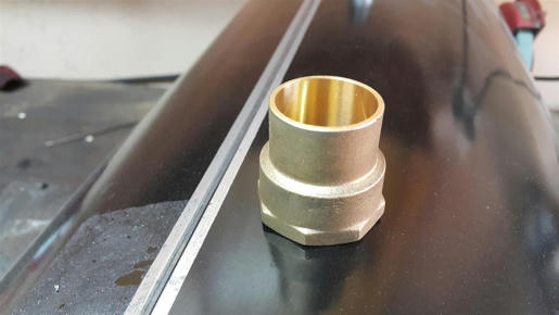

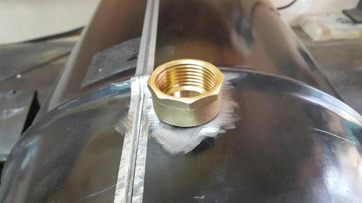

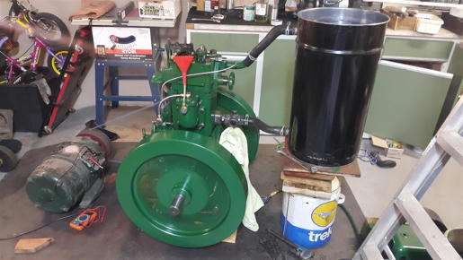

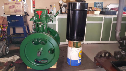

Thanks for all the inputs and suggestions from everybody. It's good to learn from other's experience.
So I got the 50 Liter drum. Looks a lot more portable!
I marked off the holes and opened them up to accept the brass fittings. Surface ground clean in preparation for silver solder.
25mm Brass fitting:
Fitting is a nice snug fit in the hole:
Engine running with cooling!!
I dug in my "box of pipes" and found perfectly suitable radiator hoses I replaced years ago on a VW I had.
The Lister water valve was a solid piece of rust. It took some heat and 4 lbs hammer to get it apart. After cleaning I lapped the valve with some valve lapping paste.
The drum and valve was trial assembled onto the engine to see how (and if) it works. After sorting the engine framework, the valve and the tank will go green.
I'm toying with the idea to mount the alternator underneath the cooling tank to reduce the footprint of the genset. Mounting it this close to the engine will slightly reduce the contact area the belt will have on the alternator pulley, but will it be significant enough to worry about?

« Reply #96 on: August 23, 2015, 09:26:04 PM »
@Dieselsmoker
"I'm toying with the idea to mount the alternator underneath the cooling tank to reduce the footprint of the genset. Mounting it this close to the engine will slightly reduce the contact area the belt will have on the alternator pulley, but will it be significant enough to worry about?"
M61hops has a good idea with the idler. On the down side, it does add something else to malfunction. I have my gen on the exhaust side with good clearance. Even so, the belt chirps whith a heavy load and damp air. (my gen set is outside, but under a roof, in the Pacific N.W.  Everything gets damp in winter.
I would be reluctant to put a tank of water above my generator. Creates a potential problem. A leaky hose or.......could be expensive.
Also, there is the issue of restricting  access to the inspection cover on that side of the engine.
Unless you really need the room, IMHO, better to keep the generator in its original Dursley position on the exhaust side of the engine.

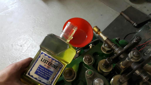

The other day I was standing in the bathroom brushing my teeth when I saw right in front of me the best container ever for topping up the Diesel when I occasionally start the engine.
LISTERine for a fresh smelling exhaust!  :laugh: :laugh:

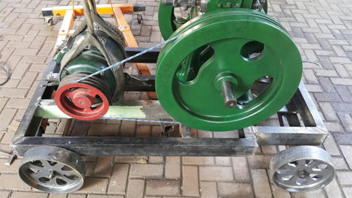

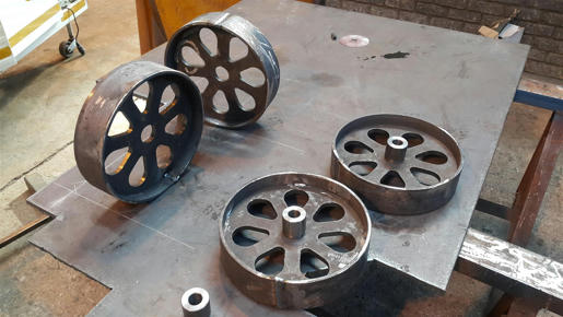

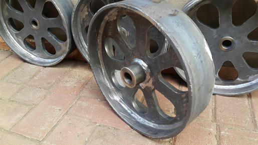

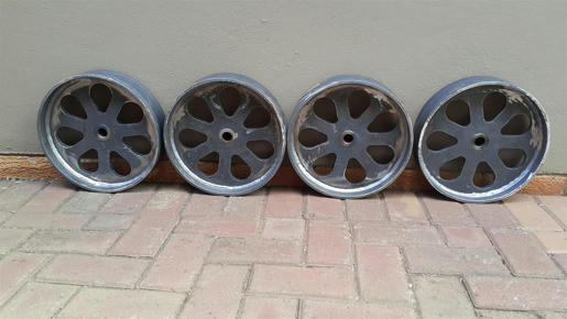

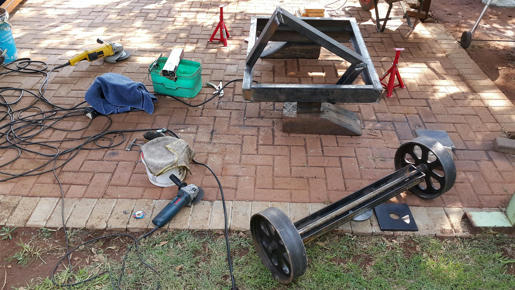

BUILDING THE TROLLEY
The biggest mission (for me anyway) when building a cart / trolley is to get wheels... And NOTHING one can buy of the shelve works visually...
When I did the restoration on the ZC208 Fairbanks-Morse a few years back I had the same problem. I designed my signature wheels and did most of the work after hours at the factory where I work. This time round access to the machines have become almost impossible. Private jobs in the factory was stopped because certain individuals abused the privilege...  I printed out my drawings and had the wheels made by a fabrication shop. (I just turned the hubs and supplied them to be welded in).
Like I said: These are my "signature wheels", but since you are such a friendly crowd I'll share my drawings. Hope it can help someone -- even if it just serves as a template for your own custom designs.

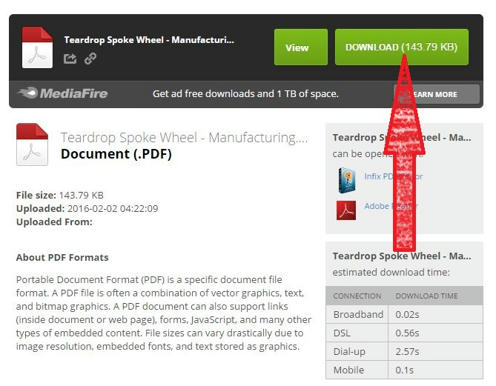

I saved the *.pdf files on Mediafire. DO NOT USE THE ON-LINE VIEWER. The viewer for some reason messes around with the drawing... -> Download the file and then open it.
http://www.mediafire.com/download/1448jmaro5fmcfs/Teardrop_Spoke_Wheel_-_Manufacturing.PDF
http://www.mediafire.com/download/dbl6hvlnd9bqu8h/Teardrop_Spokes.PDF
http://www.mediafire.com/download/j3613jg3ebkk1n2/Teardrop_Spokes_Wheel.PDF

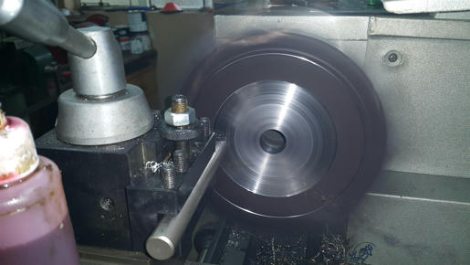

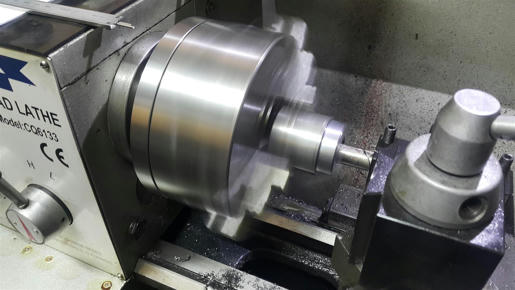

Turning the Hubs:
Delivered hubs to Fab shop. Wheels tacked up already:
All done and looking good!

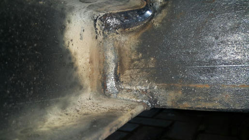

Pic showing the hub welded in position.
(This is the inside of the wheel.)
« Last Edit: February 03, 2016, 09:21:30 AM by Dieselsmoker »

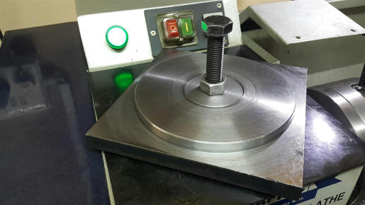

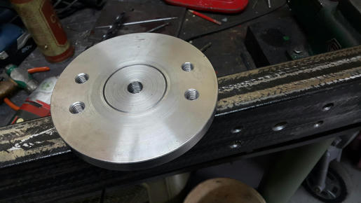

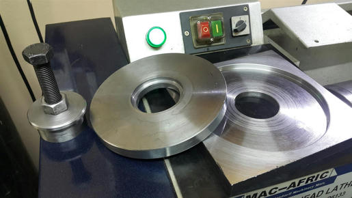

Wheels done, now the steering and the frame.
I decided to go with a single pivot for the steering. Pity I didn't go for steerable wheels instead but I'm not changing it now.
Fixed pivot point:
Male and female bits:
How it goes together. The pivot will rotate around both the large and small diameters. There should be very little play in the pivot.
Bolt holes tapped to fix the plate to the front axle.
Fabrication started. This is going to be a VERY heavy trolley...

I have a little more progress with the trolley build. I'ts taking quite a bit of time to make all the parts and weld them in place.

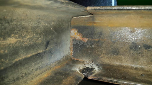

All joints are cut out like this, except some corners whith a 45 degree joints.
Fully welded - both sides.
Alternator trial fitted. I joined a piece of rope to closely resemble a standard B-Section V-belt length I want to use.
I told myself that I'll take a break after this project. I've put in many many hours of hard labor in a busy schedule and it's actually frustrated me at times. But now I'm faced with a dilemma.... This Lister is very heavy and hard to move by hand.... So I'm going to have to look for a small Holder tractor or something to move the Lister around with  ;D ;D
