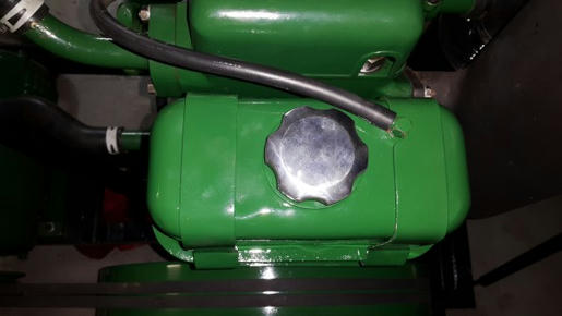

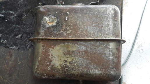

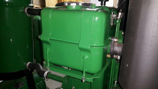

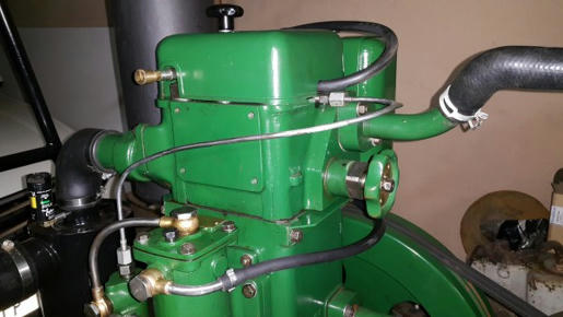

So at long last the Lister's alcohol problem is something of the past. The Magnum Cream Liqueur fuel tank is gone!

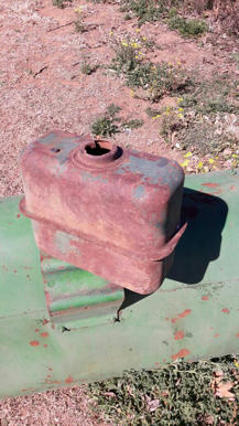

A friend of mine found this old tank on a farm lying in a field along with some other scrap.
Badly rusted and full of dents - had to silver solder some holes closed where the tank rusted through.

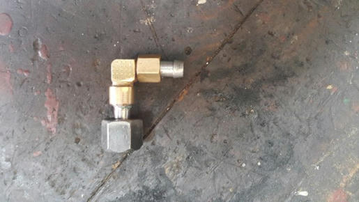

Quickly slapped together a fuel fitting. I was promised a brass fuel cock that I'll fit later.

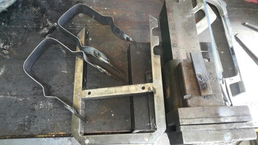

Fabricating the brackets:
At the panelbeater:
It's got a tank!!!! 8) ;D
I was lucky to find a cap at the lawnmower shop that fitted just perfectly.
Next to-do is the wiring. Looking at the quotes I got thus far I'll have to rob a bank to afford everything... The plan it to fit a volt meter, ammeter, hour meter and a reed frequency meter along with a plug outlet.
Stickers ordered from SEP a week or so ago. (They should arrive here in about 3 weeks' time.)
« Last Edit: July 30, 2017, 06:53:07 PM by Dieselsmoker »

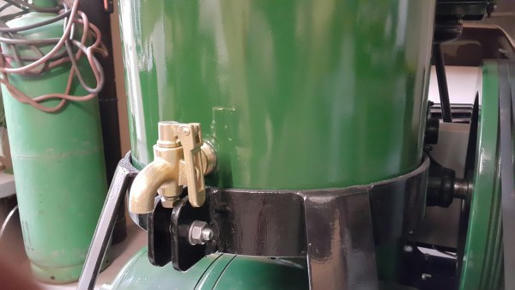

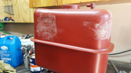

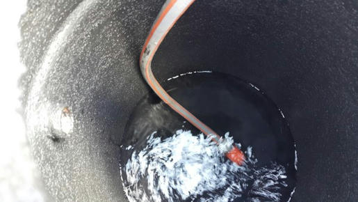

On tank number 2 I used a bitumen-based sealant that got really soft and tacky when the water got hot. Eventually water worked through the coating and the tank quickly rusted through again and sprung a leak.
This time round I got some rubberizing that is typically used on the load beds of pickup trucks. So far so good. Looks like this is really durable stuff. I also painted a couple of layers on the wheels and so far the new "tyres" are holding up excellent. No more metal-to-paving crunching. I also used the opportunity to add a tank valve so it's easier to drain the water now.
Nice thick rough rubber on the inside of the tank. Here busy with the first fill.
Brass tank valve. (What a mission it was to find a brass one!)
Brass water fittings also polished up this time round instead of being painted green with the rest of the tank.

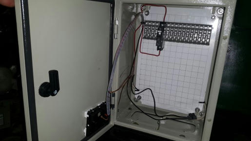

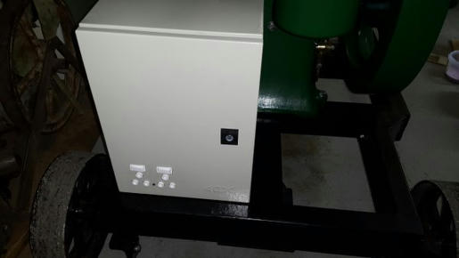

Electrical installation.

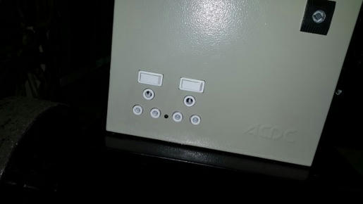

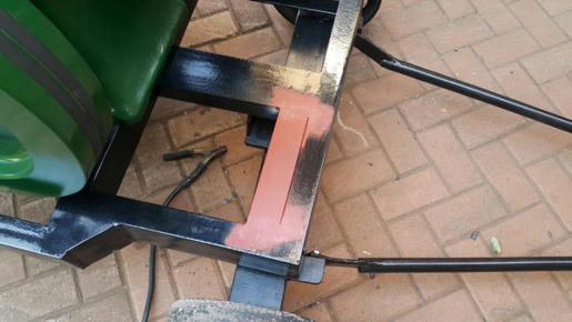

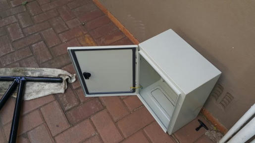

Brand new panel. Actually a bit bigger than I need, but this one was a lot cheaper than the smaller size panel  ???
Slight frame modification to allow me to bolt the panel down properly.

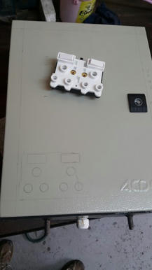

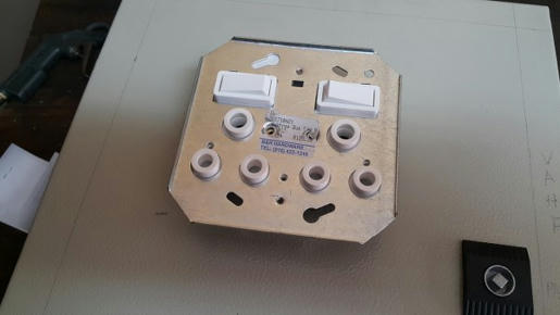

I bought a normal (fairly heavy duty) 16A plug socket at the hardware store
....and stripped all the metal bits off:

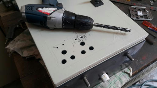

Some drilling and filing:
...and we have a power take-off!! (It looks pretty lonely down there in the corner)
So the idea is to buy all those yummy gauges and meters (when my ship comes in) and install them in the panel door. There is also space inside for an overload, maybe a earth leakage and who knows what. I have ideas - but of course I'll share when I get there. I'll very likely come pick some brains here sooner or later.

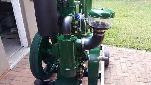

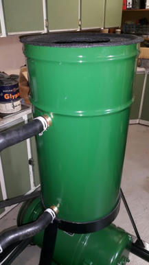

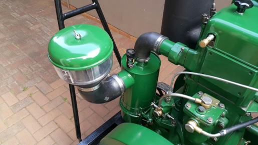

The Donaldson also got re-branded. It is now a Lister air cleaner  ;)

No it's not a silencer, but it does silence! To be frank - zero intake sound. There was a short discussion and a couple of pictures about this a few pages back: http://listerengine.com/smf/index.php?topic=7426.120
This is a "Donaldson" cyclone aircleaner with pre-cleaner. You would find this type of aircleaner on most tractors and other equipment that operate in dusty conditions. The air is first sucked through a set of angled veins to centrifugally remove heavy particles and dump them in the transparrent bowl. Hence the reference to "cyclone". The air then enters the big cannister where it yet again gets spun through a cyclone. Heavy particles are thrown to the outside and falls down all the way to the bottom into a removable bowl. Air passes through a primary dry paper element, and then trough a secondary dry paper element with finer filtration. The super clean air is then ready to be messed up again by combustion  ;D. These filters offer massive fitration capacity and effieciency. Maintenance is to periodically clean the two bowls and once in a blue moon one could clean off the dust on the outside of the paper element. Replacing the paper elements of course depends on where it was operated, but in most cases they would last many many years due to the effecient pre-cleaning. On this Lister they would never need replacing.

I started wiring the panel with what I had laying around.
I need to get a neutral bar and a smaller overload breaker. The one I have is rated at 15A. Although the alternator can do 15A, the engine won't. With the Lister only doing 550 rpm at 1460m above sea level it's not performing like it could. Loading it to 2200W, the exhaust is black and the pump is almost fully open.
