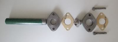

Thanks Mike, so that’s good news. It just needs cleaning out.
                I think the silencer has slowly filled half way with rainwater from the exhaust end that was outside. What appear to be the remains of an internal section must be iron scale that formed on the perimeter of the water line.
All the connecting pipes are ok except where the steel outlet pipe butts to the silencer.
It just needs an inch cut off and re welding to the flange.

There it is. It’s 20” long and 11” in diameter. On the fourth pic I’ve tried to show what I thought may have been an internal section. The structure of the cast isn’t corroded so I guess what is showing is iron scale that has collected over the years.
