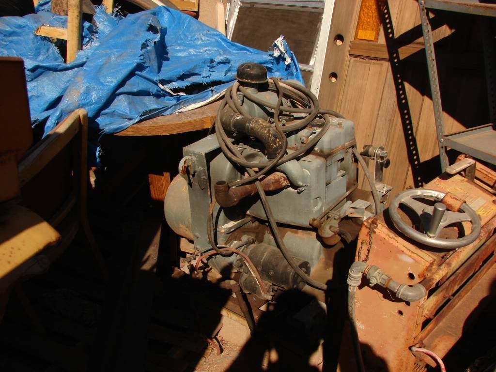

Hi, I have a lister diesel which I believe is an ST1 the number is 4319ST130-06 I would be grateful if anyone can supply me with details of this engine, Horse power age and anything else that may be relevant .

The ST1 is a great little engine. 4319ST130-06
bore/stroke 3.75 x 3.5
0.63 liter displacement
BHP continuous
8.1 @ 2000rpm
7.3 @ 1800rpm
6.0 @ 1500rpm
4.7 @ 1200rpm
fuel consumption at full load - 0.405 at 1800 and 1200 rpm
Yours is originally a 50hz 1500rpm genset build.
let me know if you need manuals or parts for this machine, our stock is very comprehensive for these.
